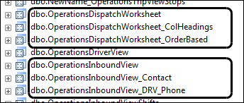

In the query, replace the view name with the new view name.
In this example, the
OperationsInboundViewdefault view has been toOperationsInboundView_DRV_Phone.
Note: It is helpful to add a custom identification at the end of the new view name. This will ensure that all related view names are listed together in Microsoft SQL Server Management Studio.

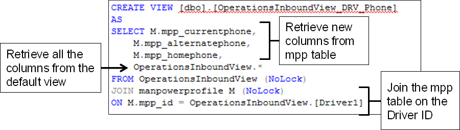

Replace the existing SELECT script.
In this illustration, the customized view is based on theOperationsInboundViewdefault view.
When the default view is updated, the customized view automatically adds any new columns.

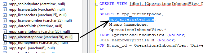

To see a list of fields from which to choose, open the Columns folder under the appropriate table.
This illustration shows columns from the
dbo.manpowerprofiletable.

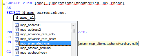

To add columns (fields) to the view, you can:
Enter each column name in the query. As you type, the matching columns are available for selection.
Drag each column from the Columns list to the SELECT statement.

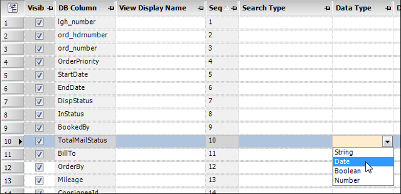

If you add a date column, you must select Date in the Data Type column of the View Editor window of Board Setup. For details, see Editing the columns for board views.

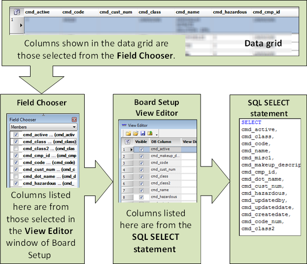

There are several ways to remove or hide unwanted columns from a grid. How and where you remove or hide them can affect the amount of data retrieved, and determine whether the columns are available in Field Chooser on the resulting data grid.
Hiding columns with Field Chooser
The columns shown in the data grid are those selected in the Field Chooser. Use the Field Chooser to hide unwanted columns from the data grid layout. This allows you to use one board view to create multiple grid layouts, each with different columns.
Individual users can also use the Field Chooser to add or hide columns. However, if you want to prevent users from accessing the Field Chooser to change their setup, you can prevent users from modifying data grid columns. For details, see Preventing users from modifying data grids.
Hiding columns from a Board View
The columns listed in the Field Chooser are from those selected in the View Editor window of Board Setup.
See Editing the columns for board views to prevent columns that are in the SQL view from displaying in the Field Chooser for the related data grid. This allows you to use one SQL view to create multiple board views, each with different columns hidden.
Note: You cannot edit columns for a shift planning board view. An example of a shift planning board view is the ShiftPlanningDriverView.
Removing non-required columns from SQL
Few columns in the default planning board views are not required. Because you must not remove any required columns from a view, you should know which columns are required.
To view the required columns for the Board Type, run a SQL SELECT script against the PlanningBoardRequired table in Microsoft SQL Server Management Studio.

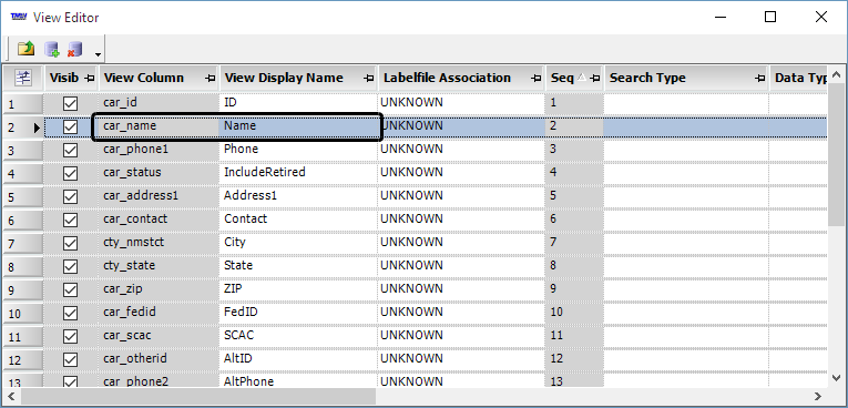

If you rename a column in the Board view, you must open the View Editor window to identify the database column name from the SQL. In the View Editor window:
The View Column name shows the database column name
The View Display Name column shows the column name in the data grid
In this illustration, the column name was changed from car_name to Name.

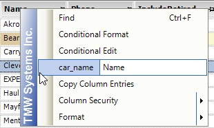

Right-click on the column name in the grid.
The shortcut menu indicates whether the text was changed. The default column name displays first, followed by the new column name.
