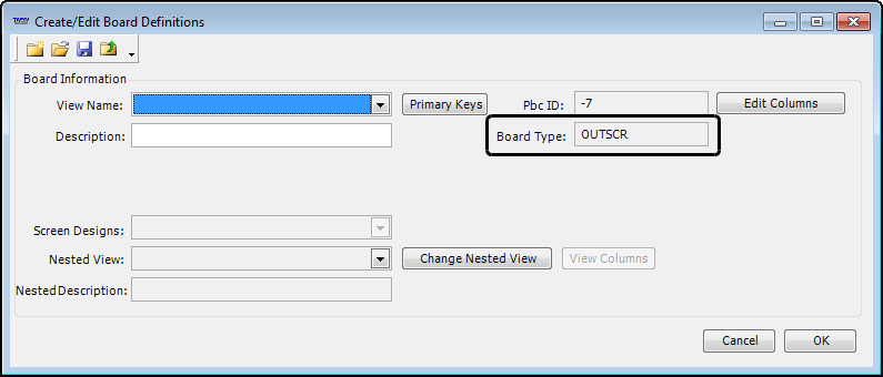

Click New.
 The Create/Edit Board Definitions window opens. The value in the Board Type field differs depending on the view.-
Outbound view: OUTSCR
Inbound view: INBSCR
Shift view: SHFSCR
Appointment Scheduler view: APPSCR
