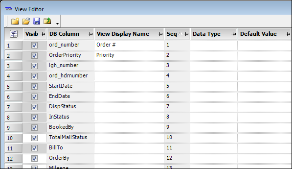

Click Edit Columns.
 The View Editor window opens. Field Definition Visibility Checkbox used to indicate whether or not the column is visible in the board. DB Column Name of the column from the database table, or as it was renamed in the SQL SELECT statement. View Display Name Enter the name of the column that should display in the Field Chooser for the board view. Seq Order the column will appear in the board view. This field is read-only. Note: If you want to change the column order, you must make your changes in the grid and then save the grid’s layout. Data Type Use this field for date columns you added through the SQL view. Default Value Use this field for date columns you added through the SQL view. Enter the default value that will replace any NULL values in this field. This field defaults to 01/01/1950. Last Updated By Displays the user ID of the individual who last updated any columns in this data row. Created By Displays the user ID of the individual who first modified any columns in this data row. Created On Date the initial modifications were made to any columns in this data row. LastUpdateOn Date the last modifications were made to any columns in this data row. You can do any of the following: -
Hide a column Clear the Visible checkbox to remove it from view. -
Required columns: The Visible checkbox has a gray background. If cleared, data will still be retrieved by the view.
Optional columns: The Visible checkbox has a white background. If cleared, data will not be retrieved by the view.
Change the name of a column heading In the View Display Name column, enter a new name or change the existing name.
If you added a column that is a date, under Data Type select Date. This example shows the driver’s seniority date was added to the Driver Scroll view. The Default Value column shows 01/01/1950. If the driver’s profile contains a NULL entry, this date will display in the grid.
When finished, save the changes. -
