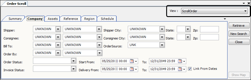

The scroll views are used in the Scroll windows.

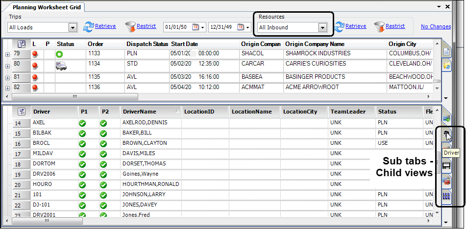

The planning boards have their own views as well as child views. These are the resource grids that display when you access:
The Driver, Tractor, Trailer, or Carrier sub tab in the lower section of the Planning Worksheet. In this example, the Drivers sub tab is selected. It is a child view of the All Inbound view.

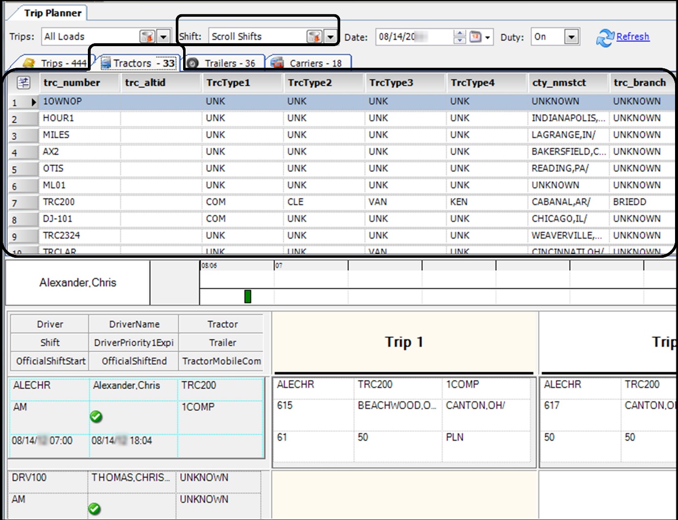

The Tractor or Trailer sub tab on the Trip Planner. In this example, the Tractors sub tab is selected. It is a child view of the Scroll Shifts view.  Note: The Carrier tab on the Trip Planner is reserved for future functionality.
