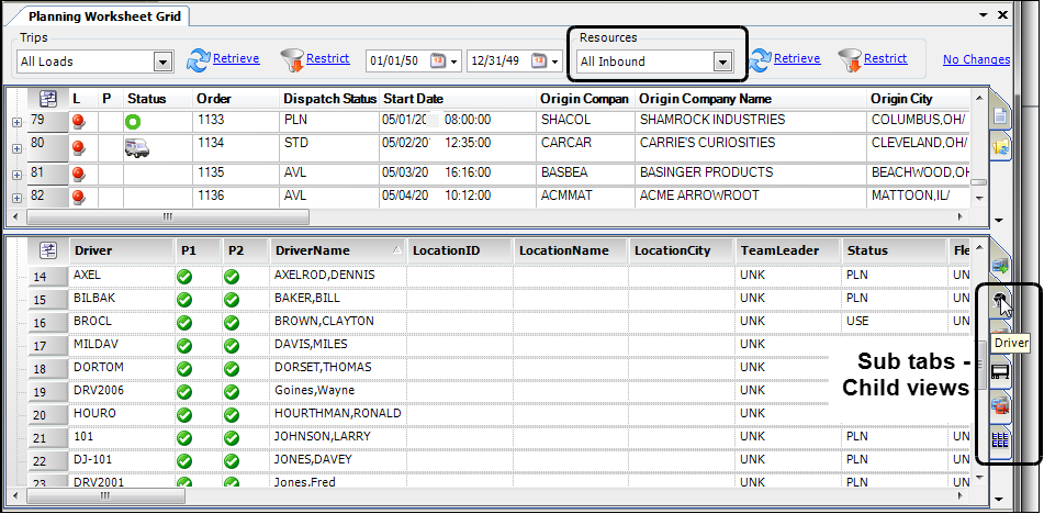

The planning boards have their own views as well as child views. These are the resource grids that display when you access:
  • The Driver, Tractor, Trailer, or Carrier sub tab in the lower section of the Planning Worksheet.
    In this example, the Drivers sub tab is selected. It is a child view of the All Inbound view.

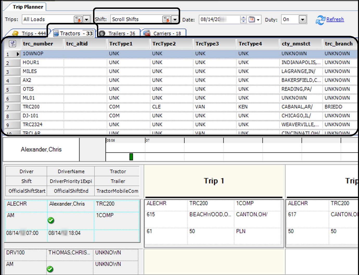

  • The Tractor or Trailer sub tab on the Trip Planner.
    In this example, the Tractors sub tab is selected. It is a child view of the Scroll Shifts view.
    Note: The Carrier tab on the Trip Planner is reserved for future functionality.
